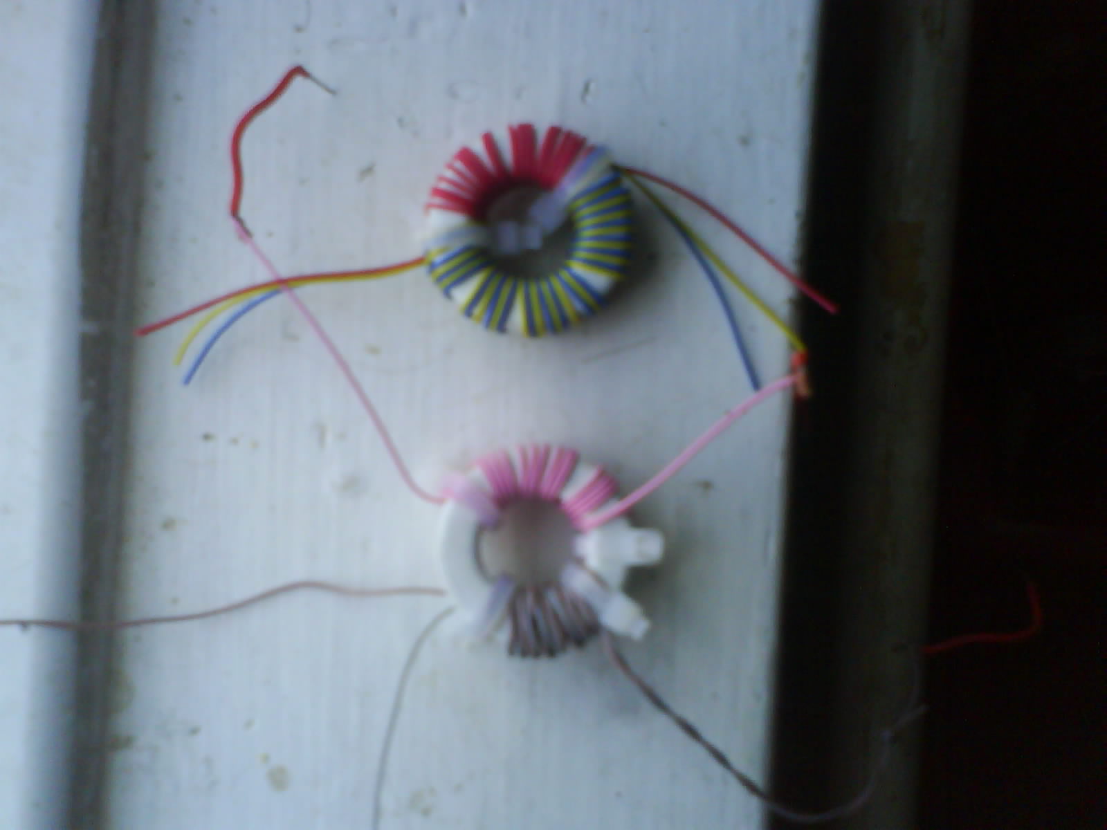

Would you post details of the home wound coupling transformer.?

I think it could be possible but the grade of the ferrites that I have are 3E25 and unfortunately in the table there are no values for the operating frequency at this grade. I do get an output on the transformer and the wave looks exactly like the input so I'm guessing its within the operating frequency, I will do a few tests later to see how much current I'm getting from it. I'm just wondering if the comparators arent liking their input voltages because they are a little on the high side - about 18V. I will step the transformer down further to see what I get.
Google search for '3e25 ferrite' and you'll find a lot more frequency data. The datasheet on rcgroups.com seems pretty comprehensive.
