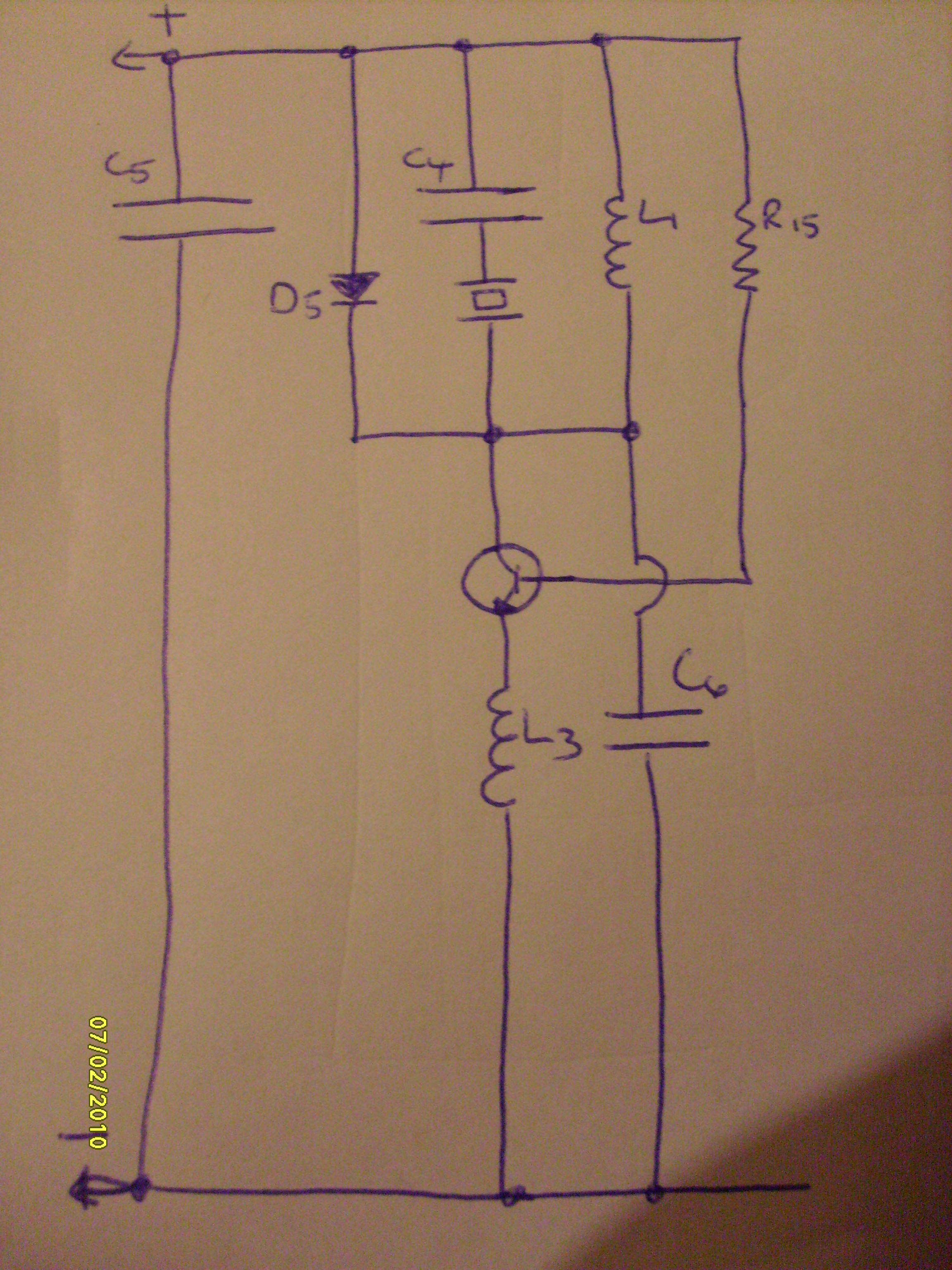

L3 and C6 form the resonance circuit and determine the working frequency. (These are also noted as Lr and Cr)
Currently: L3 and C6 = 4uH and 1.5nF = resonance at 1.6MHz
I need to change to: L3 and C6 = 115uH and 27nF = resonance at 100KHz
In order to match reactances L1 should also change to 1mH
So essentially I'm scaling these 3 parts up by 16 (approximately)

The capacitance to calculate the resonant frequency is the series combination of these parts:
C6 – 1.5nF
C5 – 22nF
and the piezo (2.25nF) in series with the 0.1uF and both of these in parallel with the diode (15pF) = 2.215nF (effectively the piezo element itself).
The series combination of these = 859.4pF. [C6, C5 and piezo combo]
The inductor L1 = 60uH
The oscillator starts up at the LC tank frequency of 700 kHz. The piezo resonates at 1.67Mhz. It is modeled as a capacitor in parallel with a series combination of capacitor, resistor and inductor. It is positioned between the collector and the base of Q1 providing feedback. Once the circuit begins oscillating the piezo takes over as the crystal oscillator element. This is observed on the scope as a much larger amplitude wave at a 1.67Mhz frequency and the piezo element buzzes (the low frequency envelope is audible). The piezo operates as an inductive element and the circuit provides the capacitance.
Attached are some screen captures of the Q1 collector voltage at start up and after oscillating. Unfortunately, the device ran too long dry and the piezo element died. Now the circuit only resonates at the RC frequency (a learning opportunity…).
The component values are also chosen for their reactance values at the operating frequency of 1.67 MHz so that the transistor biasing is correct for stable oscillator operation. These are:
L1 – 60uH – 630 ohms
L3 – 3.4uH – 35.7 ohms
C6 – 1.5nF – 63.5 ohms
C5 – 22nF – 4.3 ohms

I pretty much get impedance now, thanks. I have done some calculations.
The original circuit at 1.67MHz has the impedances below from Eric, see attached schematic.
L3 and C6 determine the resonant frequency - 1.67MHz
C4 is DC blocking
L1 and C5, C6, D5 and the piezo determine the tank circuit - 700KHz
My calcs for 130KHz
L1 - 1mH -628 ohms
L3 - 60uH - 38 ohms
C6 - 27nF - 61 ohms
C5 - 350nF - 4.5 ohms
C4 - 1.6uF - 1 ohm
I've just realised i did these calculations without taking into account that the atomiser I want to use at 130KHz has an impedance of 50 ohms. As opposed to 2 ohms for the 1.67MHz one above.
I will have to have a think about how that will change impedances. I hope this shifts down the tank frequency because I did some rough calcs and they came pretty close to 130KHz. So many things to remember...
