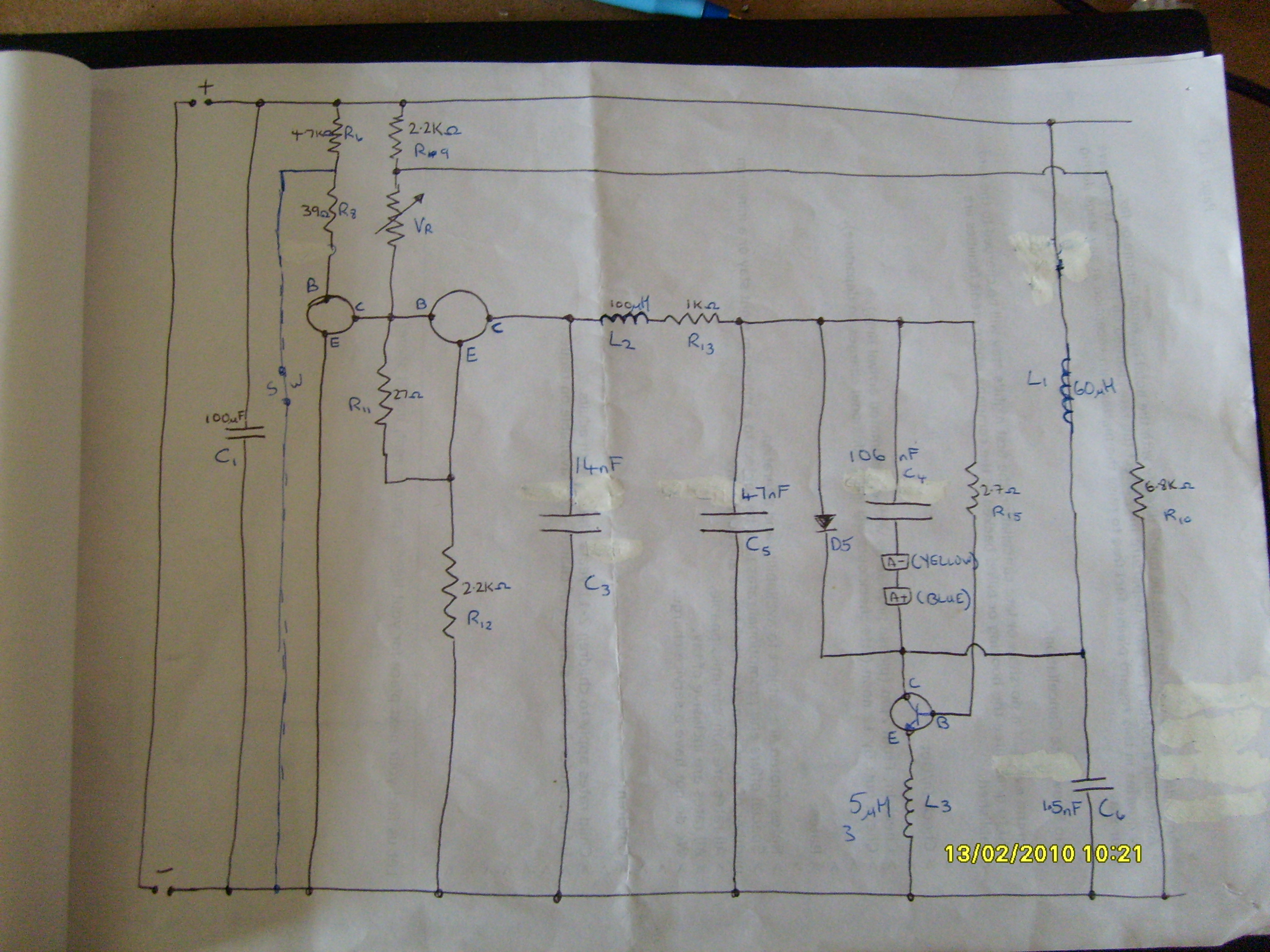

Tuned LCR circuit for humidifier

Hi Unclejed,
I bought some piezo tweeters a while back to take apart. They seemed to be a piezo diaphragm with a horn, I think these must have been a siren and what you were looking at is different.
I've got a lot of piezo electronics on the go now! Makes me happy though, I like a challenge!

Hi Eric,
Thanks. I'd say you were very skilled at piezo work and patent analysis. Makes me wonder if you already have some patents. I like those Buzz Stain Removers. I had a look and one embodiment is mentioned as working at 50KHz. Which is in a good ball park for me.
I just bought an oscilloscope. Its nothing fancy but should be sufficient for my purposes. I'd have prefered a slightly higher frequency but 2MHz will be ok. Incidentally we had the gas man here to fix the boiler last week and he had exactly the same model.
I need to find an order to project work. Probably this:-
1) Alter compoents on the steminc 1.67 MHz circuit and 2.5MHz. Look for 133KHz.
2) Wire up the general purpose opamps and see how they work. Build a simple circuit.
3) Build neb2 or something similar.
4) Find out how to use the power opamp and build a circuit.
Can you think of any useful experiments to carry out? I'd like to split the tasks into smaller sub tasks.
Unclejed. If you were starting out with these tasks what would you be looking for?
Thanks,
Antknee.
Hi Antknee,
I'm an electrical engineer from way back and do much patent work today. Resonance phenomena have always been a keen interest of mine.
Good deal with the handheld scope. This is a required tool for oscillator work.
If you only want to energize the piezo element that you have inorder to investigate something then the Buzz could work for you.
If your interest is making your own circuit for a product application then build one from scratch with the parts you ordered. The neb3 circuit seems a very stable oscillator design to start with. Use a project breadboard to allow parts adjustments.
Build or buy a DC power supply that can provide the voltage and current required.
Build a simple 555 timer circuit to generate your signal. Run that through your audio amplifier chip (LM3886) and through an audio transformer to the piezo.
Eric

the LM3886 has definitely run out of gas at 1+Mhz. you can use it for 50-200khz piezo elements, but not 1Mhz.
you can transformer couple the piezo if the amp has problems with the capacitive load.
NC pins should be left open, don't connect them to anything. quite often they are internally connected to something, maybe for factory test purposes (like monitoring the output stage bias while the bias is being laser trimmed), but should never be tied to anything externally.

Unclejed's right about not being able to drive the 1.67Mhz piezo with the LM3886. I thought your target was a 130Khz element?
Don't worry about the optional parts on the LM3886 datasheet. You will be running the amp through a transformer to match to the piezo, so the load will not be capacitive. I left only the essentials on the attached schematic. This circuit can drive your 130Khz element near resonance. The LM3886 will require a +/- power supply unless you wire it for single rail use and add a transistor to the circuit (see the datasheet for single supply wiring).
The 555 timer circuit is a useful oscillator. Use this page to calculate the resistance and capacitance values for the desired frequency:

Tonight I spent 3 hours working out how to use an oscilloscope. It's a very cool gadget! The new oscilloscope is pretty accurate, portable, durable and should do everything I want.
I was testing the circuit I started this post with. I was certain the transistor was rectifying the signal to half of a wave, I'm not sure why, but it is a full wave.
I was inputting 24V AC, across the piezo was 1.72MHz, 29.5V AC, with a high of +32V and low of -62V (around 100V peak to peak).

2 things about your meter.. DMM's don't like 1800V of anything. i've seen meters die from that kind of voltage, even as random spikes... second the AC voltage function is usually only good to a couple of khz, unless it's an audio True RMS meter, which is good to 100khz or so.

I've costed up a circuit based on neb1. It seems best for my application including water level detection shut off to protect the piezo and the lowest current draw. Depressingly, I found the complete neb1 assembly available for $10 US in quantity 1,000 from a China manufacturer. Have to buy from that region to get low cost piezo elements anyway....why not pick up the complete assembly...grrrr....:(
Attached is an improved neb1 schematic. Includes L2 (5mH on my board) and readily available actives.
Regarding your scope - amazing for the price. Yes, the piezo drive signal is a full sinewave. It rides above ground (never negative since supply is 0 - 36VDC). You can verify this on the scope.
Transformer: Find an old transistor radio (broken boom box, etc.). You will usually find an audio transformer in one of these.
