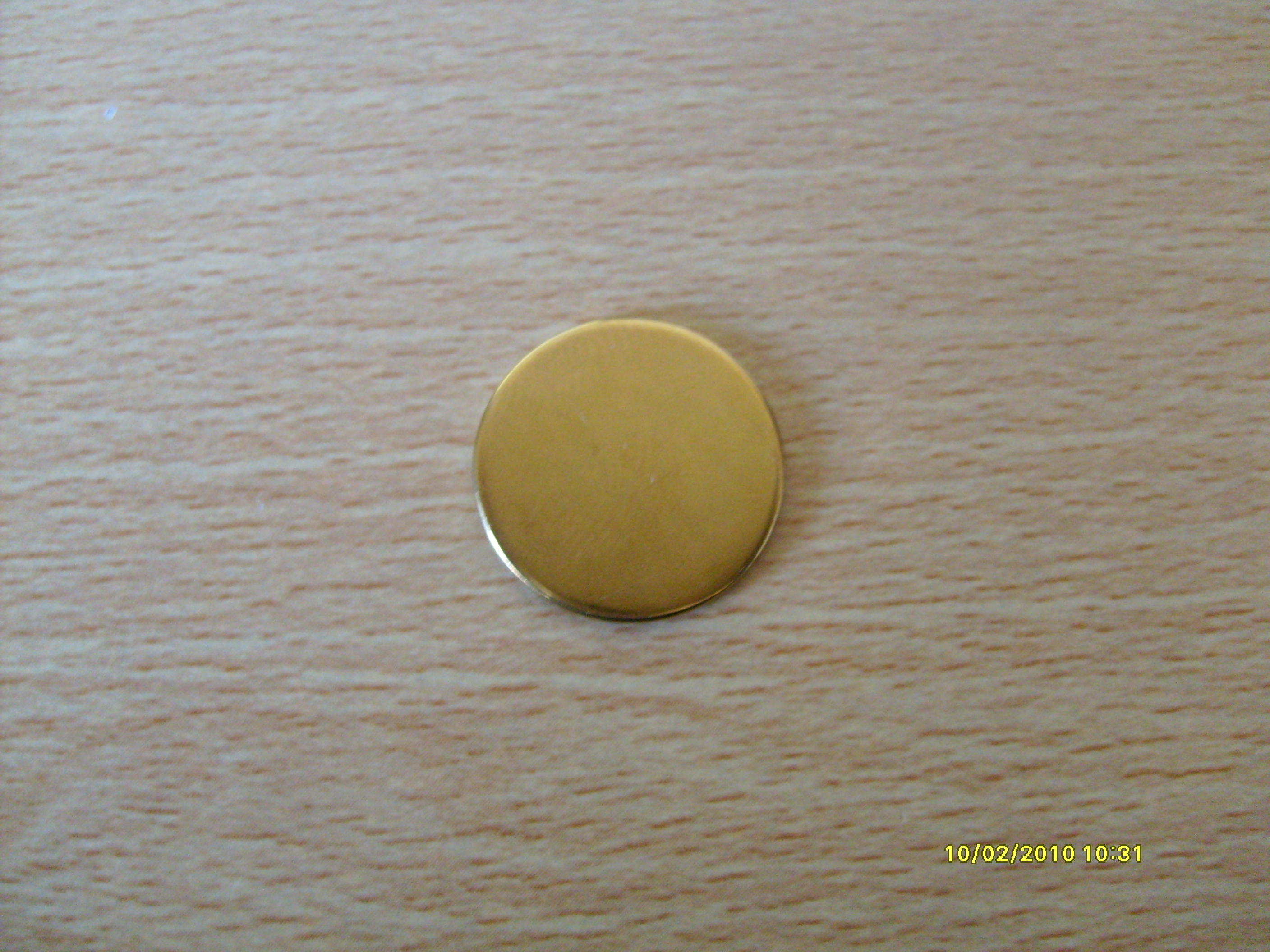

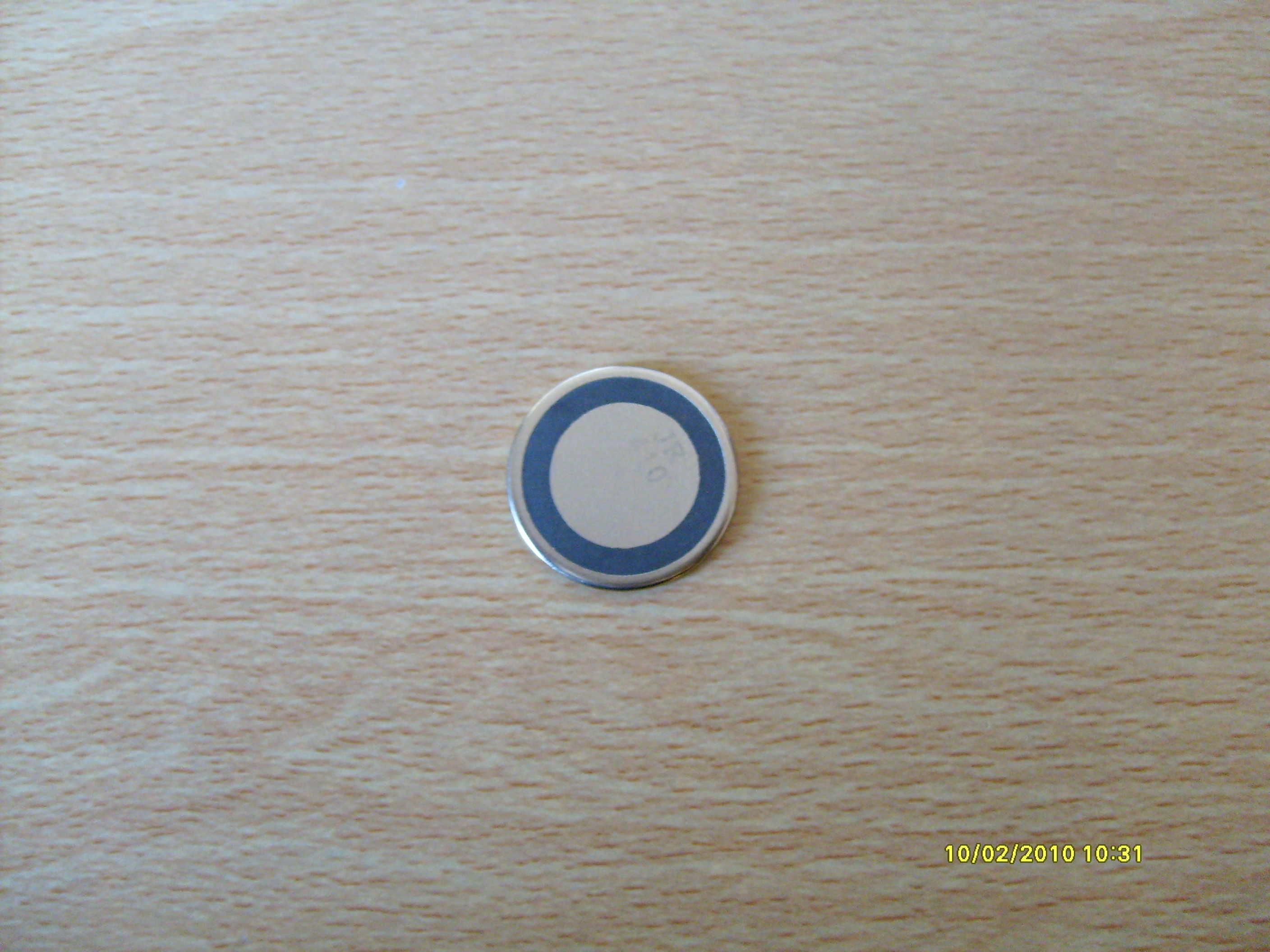

I took apart the fogger I bought last night. I dont think it was a piezo, the circuit is actually in the power adapter, it sends the power to the spring and the spring is in contact with a brass plate, see pics. I was a little surprised that the circuit was in the power adapter, because I used the same adapter with the board we've been looking at. And it worked! When I get a chance I'll take apart the power adapter and see what is going on.

I too will be building one up from scratch. The device you show could be a piezo element. Can you measure capacitance of it?

The brass plate is a piezo after all. It had a capacitance of 1.7nF. I spent half hour sawing through the fogger 'block'. It was stainless steel case filled with a heavy plastic that had been poured in. I was expecting to find a circuit board and there was just wires for the LED, water level sensor and piezo element. The spring was there to increase the amplitude of vibration I presume. I've never taken a fogger apart, all seems fairly obvious now though!

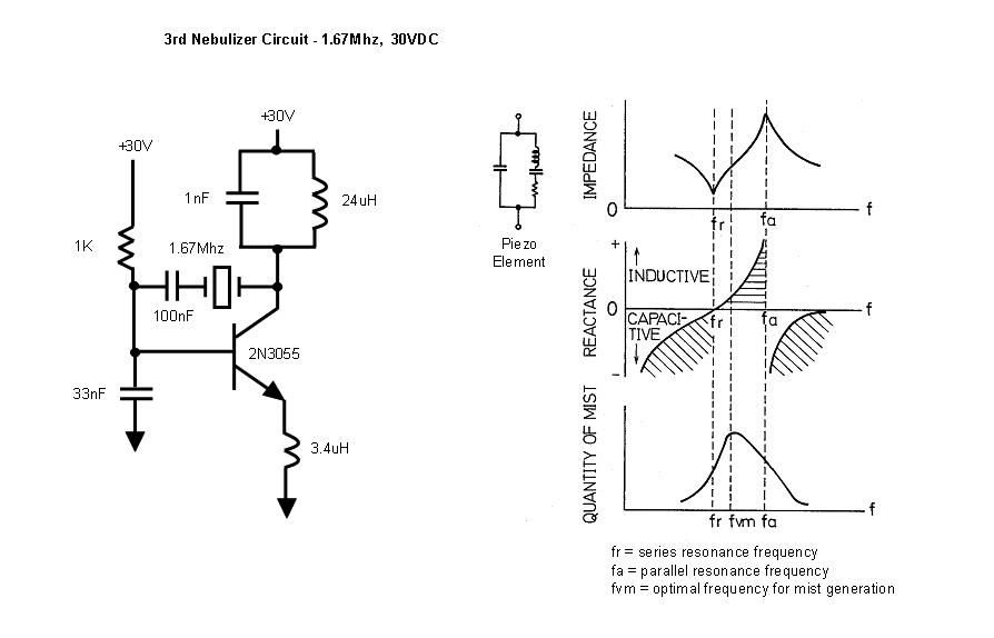

Succeeded in building a working oscillator from parts this evening. Attached is the schematic. Theory is from a nebulizer patent - optimal mist generation occurs when the piezo is operated at a frequency where its reactance is inductive. The tank circuit (parallel LC) resonates at about 1Mhz.
This circuit requires a hefty power supply (current was 1.5A).
Eric

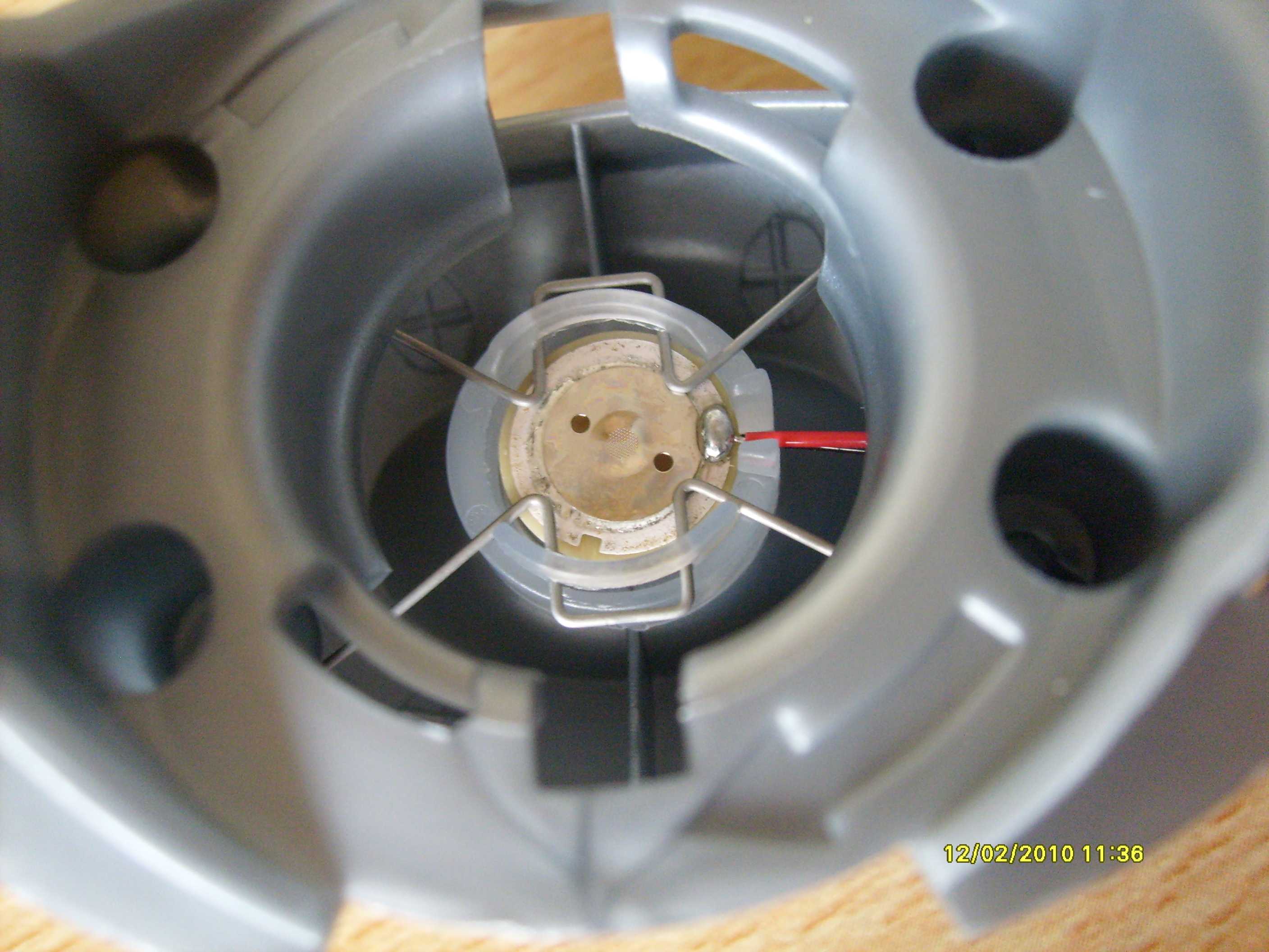

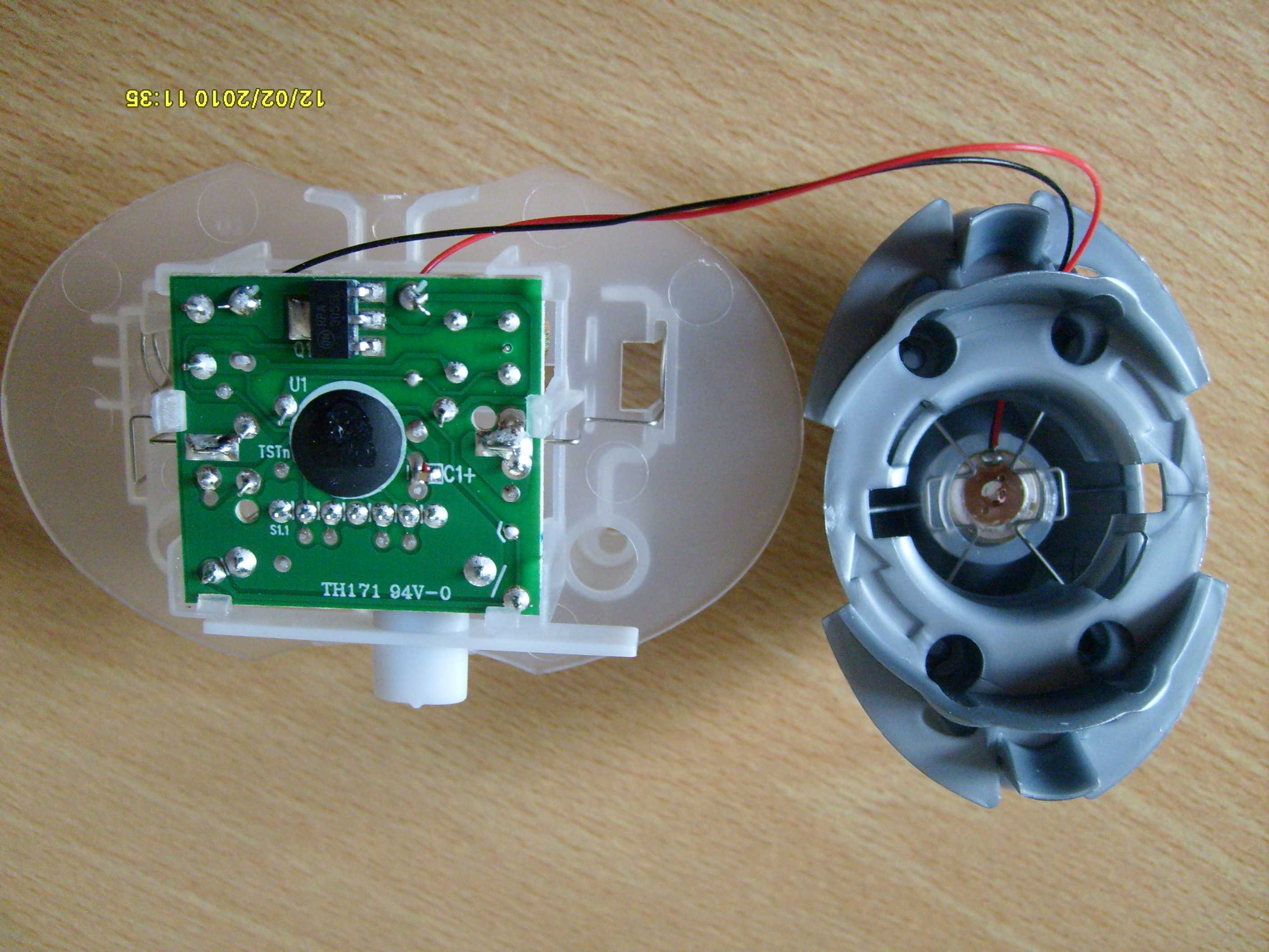

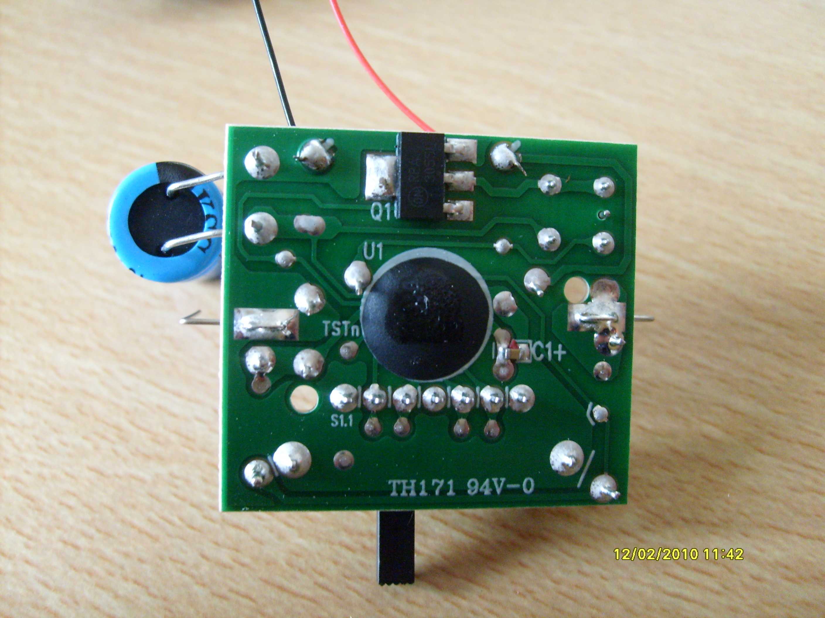

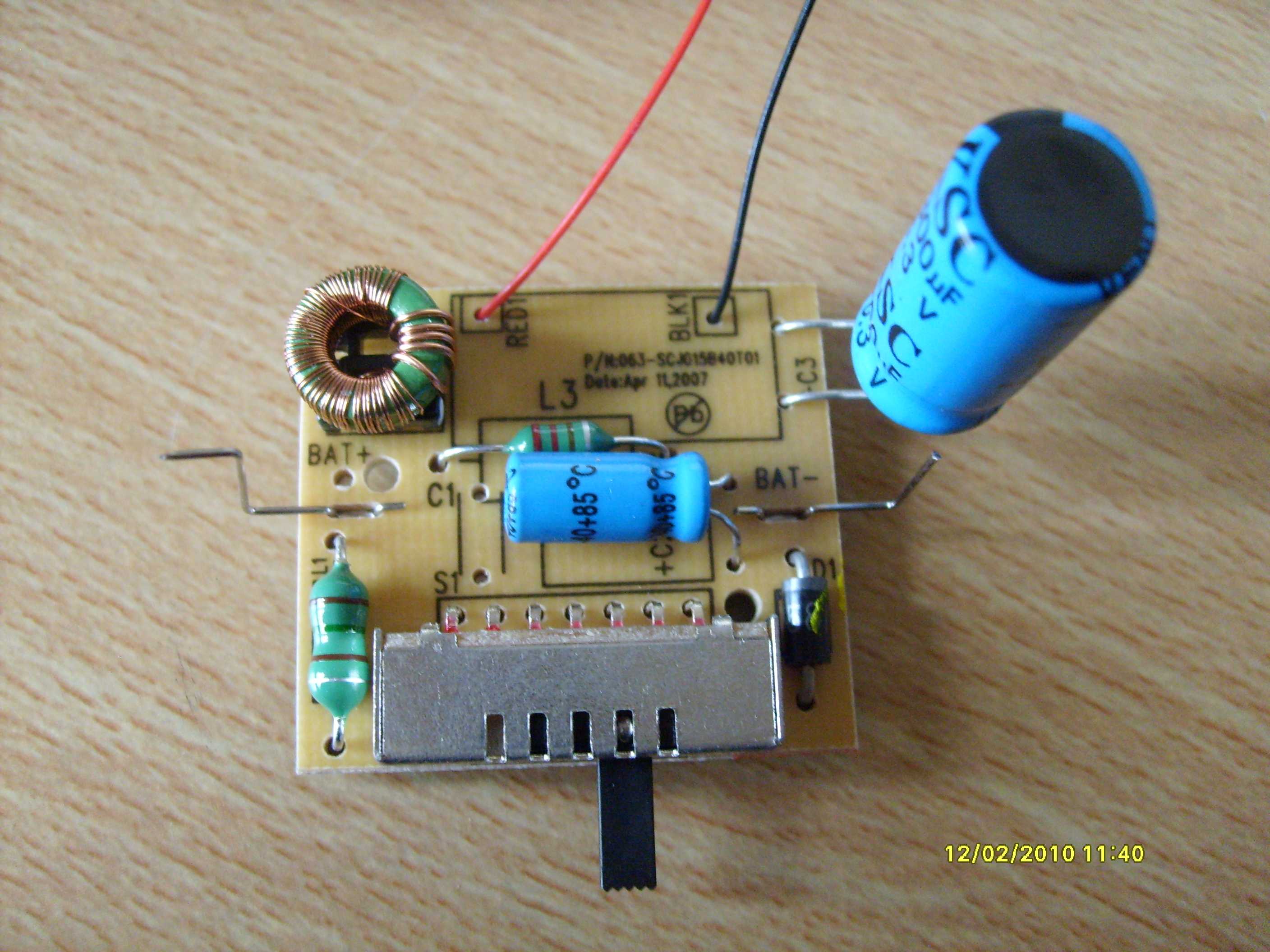

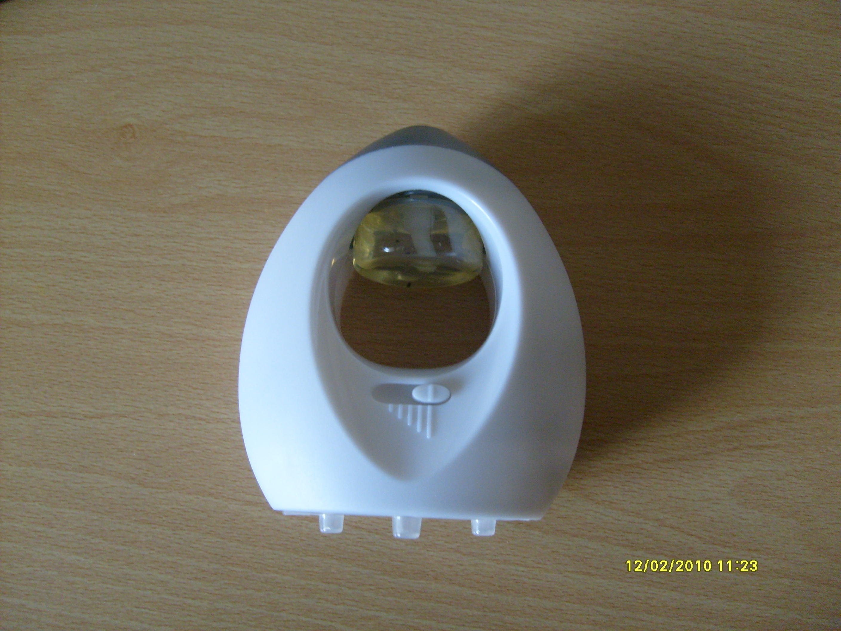

I have taken some pics of what I know as the Glade 'Wisp', it has a derivative called the Glade 'Candle'. It is the only air freshener that uses a piezo element (that I know of). I haven't mapped the schematic of the circuit but it is probably one of those that has been patented. It looks very simple, with a single AA battery sending charge to a 3300uF electrolytic, it charges at various lenghts of time dependant on the slide switch, potentiomenter. The resonant circuit is the toroidal inductor with a 47uF electrolytic. There is a transistor on the reverse of the circuit board probably rectifying the voltage. There are also a couple of chokes and a diode and that seems to be it! It is a little low powered for me but for simplicity it gets plenty of marks.

Hi Antknee,
1. Your Glade - Yes, the epoxy blob top marked U1 is the IC and the heart of the circuit as described in the patents.
2. Yes, there are patents on the candle version as well.
3. LM3886 - I've used this audio amplifier in the past to drive piezo elements. It will work fine. You will need an audio transformer to couple the piezo to the LM3886 output as it expects 4-8 ohm speakers. Radio Shack sells one that works fine (8 ohm one end, 1K ohm the other). For that matter I have used an old stereo amplifier and the transformer to drive piezos with a signal generator.

Antknee,
The piezo driver on your Glade is a power MOSFET from On Semiconductor. Here is the data sheet:
NTF3055L108
Eric
