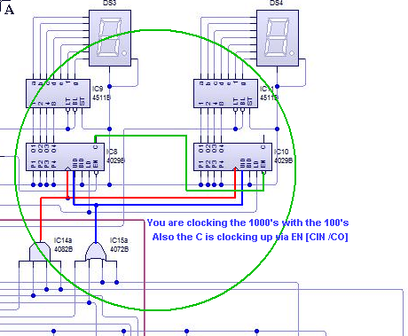

Add the two AND gates to CIN/Co as shown in this drawing.

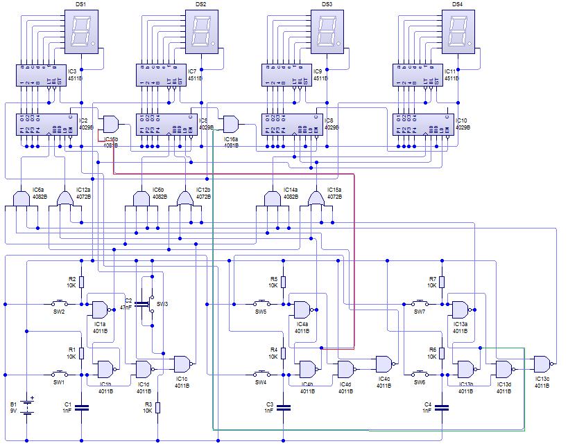

I have connected the AND gates to the circuit, and on the attachment, i have just coloured the rails so that it is easier for you to see the connections.
What is not working this time is the following:
For the units (for both count up and down)
0000,0101,0202,0303...0808,0909,1010,1111,1212,1313,1414 etc. [counts up in 101s]
For the tens
[Count Up] 0000,0011,0022,0033...0088,0099,0110,0121 etc [counts up in 11s]
[Count Down] [After Count Up Is Pressed] counts up in 1s
[Pressed Straight Away] counts up in 101s

[Count Up] Counts up in 101s
[Count Down] Counts down in 1s.

One point is you have not added an AND gate between the 100' and 1000's for starters, my circuit is shown for only 3 decades.
All the connections between 10 and 100 must be repeated for 100 to 1000

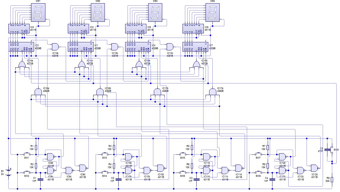

I would have thought could have worked out for yourself, how the additional gates for the 4th decade are connected.:rolleyes:
Its just a repeat of the 1,2 & 3rd decades, its now all in this last image.
I did tell you that the circuit would grow like topsy as you decided to add features to it.
I hope you have learned an important lesson when embarking on a project, do the paperwork project specification/proposal FIRST, which should include ALL the features the project NEEDS to function, BEFORE starting the design... and to resist adding features to the project as it progresses....:)

You have to have the clocks and the CIN/CO connected to the 4th decade using gates else you will get the problem you are seeing.!!!!!!!!!!!!!

Those extra features you mention are required to make the circuit work, the 4029's are clocked as a synchronous up/down counters, so to clock any of the 4029's individually up or down, the inter 4029 gating circuits are required.
Run that complete last circuit I posted in simulation and see what you get.

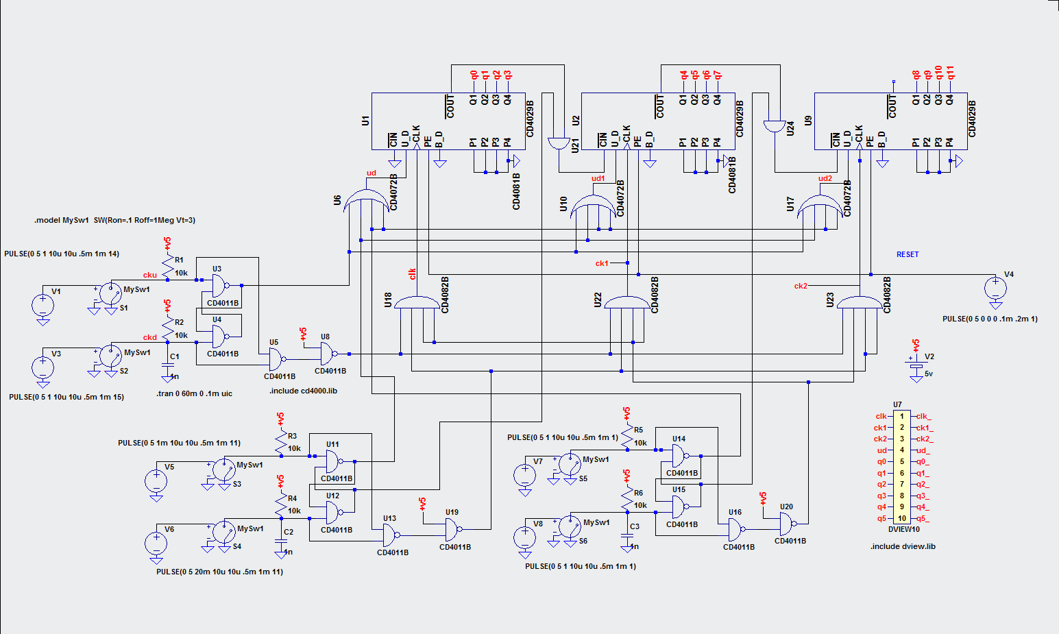

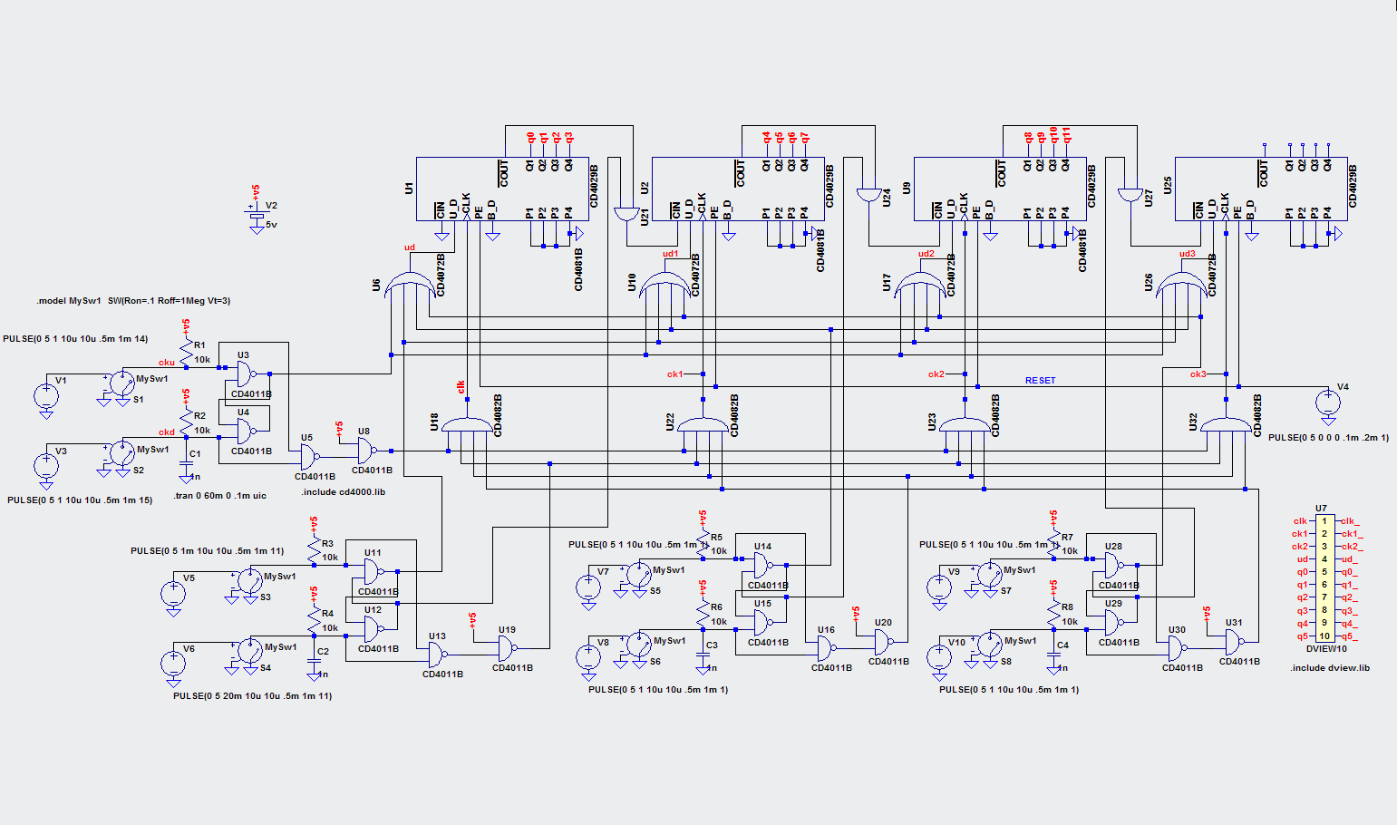

Could you send me your schematic sim you have thus far.I have livewire made by the same company as Circuit Wizard (New Wave Concepts) but perhaps you ought to re-think your design to suit Eric's circuit.
One thing to remember in some Sim's is they don't always simulate as they would act in real life:confused: yes I realise this sounds a little stupid so I brought this up with New Wave concepts who suggested I update the software..still I get simulations that don't work as they should..the result is we think we have designed the circuit with errors.

Attached is my circuit. [Note: it is a big circuit and so may not be easy to see, as the size had to be reduced to fit the picture]

Post the file so I don't have to draw it all, I will simulate it on my PC.
