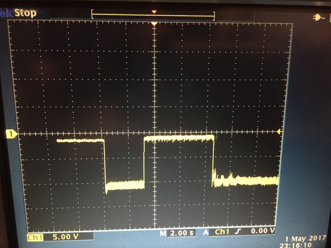

Gents.
I have a Signal that is reading a negative voltage. I wish to condition it so i can read the Anologe Voltage wit my PIC.
Can anyone help me on how to condition the signal to get a positve voltage in reference to graund.
Signal below. would like a 0 - 5v Representation of this signal?
Thank you

This signal can vary to about -17V.

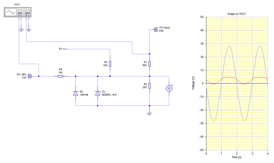

I think I have come up with a solution and wonder if anyone could check it. Please see attachment. Let me know if this would work to connect to my ADC of my PIC.

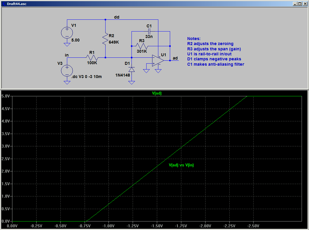

Even simpler, how about this for a 0V to -20V input?

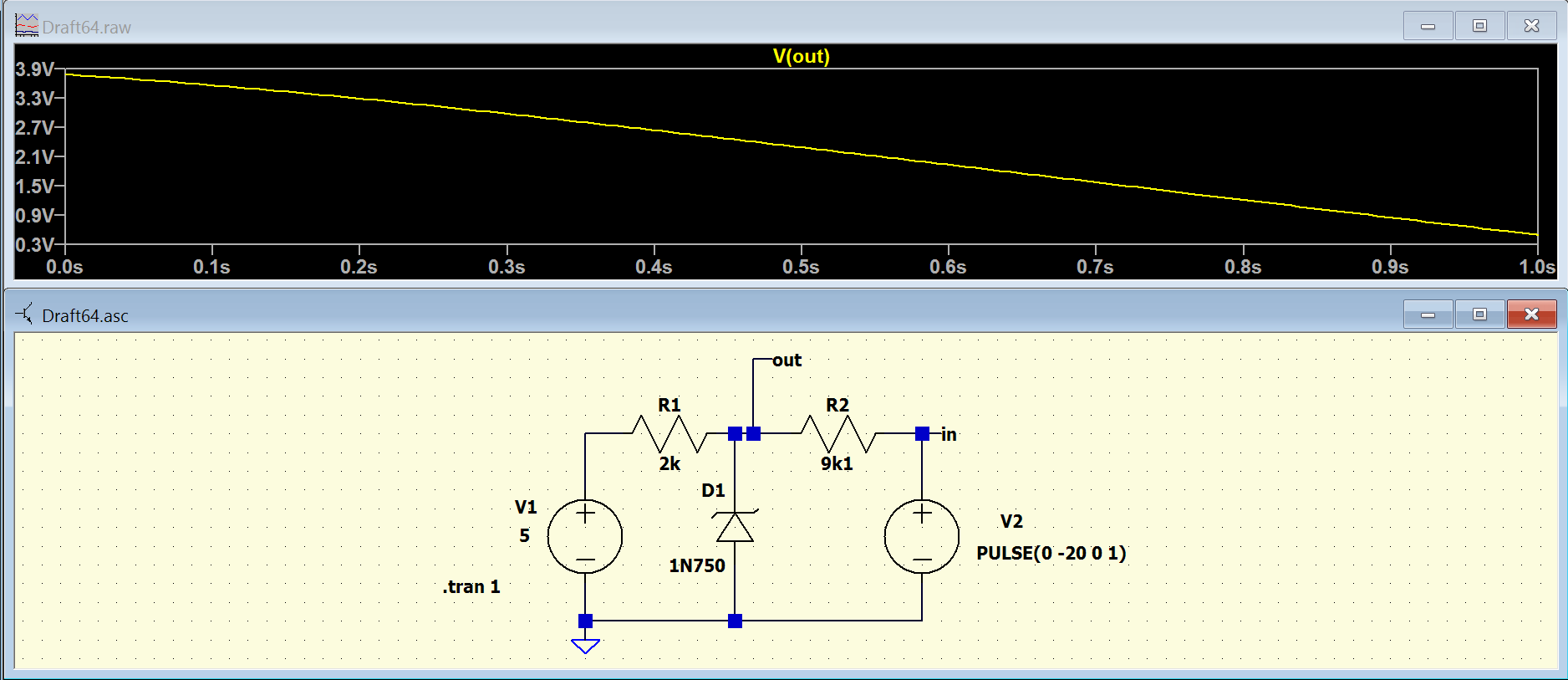

Try this:

The signal I have from the vehicle are 2 wires. Let's call it signalA and SignalB.
If I measure signalA in reference to signalB I measure a constant 15V with no stepping. If I measure SignalB in reference to signalA I measure the original attachment above.
I need to see the stepping as this is the condition I'm trying to monitor.
So it's not as simple as measuring the negative voltage because I cannot join the grounds together. Does this make sense

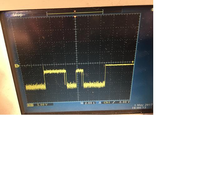

Ok. I can do it withgout the engine started, just a lower voltage due to the alternator not running.
Measurement 1
Channel 1 - Signal B refernce to Signal A
Ap Approx 6 seconds, igntion on
At Approx 9 seconds, selected 1st Gear
At Approx 14 seconds, selected Netueral

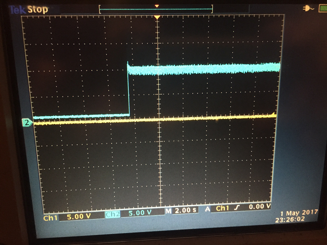

Measurement 2
Channel 1 - Signal B Reference Vehicle Ground
Channel 2- Signal A Reference Vehicle Ground
At approx 8 seconds - Ignition On
On selection of Gear - No Change
I hope this all makes sense now....
Note : In Measurement 1 it is alittle different when the vehicle is started - See original post #1

This does NOT make sense. Look at the lower scope picture. CH1 (yellow:B) is 0V for 20s. CH2 (blue=A) starts out ~1V, and then switches to ~10V +- 1V of noise at 7.5s. The upper photo does not show the difference between CH1 and CH2; it shows something different.
I am thinking that at least one of the signals are coming from an open-collector type output, and you need a pull-up resistor to reveal the true nature of the signal.
Try connecting a 10K to 100K resistor between A and B, and then show us A and B wrt carGnd again.
This does NOT make sense. Look at the lower scope picture. CH1 (yellow) is 0V for 20s. CH2 (blue) starts out ~1V, and then switches to ~10V +- 1V of noise at 7.5s. The upper photo does not show the difference between CH1 and CH2; it shows something different.

The input resistance of the scope is either 1meg or 10meg per channel. The two input resistances act in-series as a 2meg or 20meg pull-up provided you let the chassis of the scope float with respect to carGnd. The reading likely is bogus...

I already told you. Hook a 10K to 100K resistor from A to B and then post V(A) and V(B) with the scope ground connected to the car.
