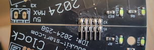

About Mid August, this thread inspired me ... My variation is a MQTT clock that is set by the internet. Not only can it function as a clock, if you have another MQTT device that for example measures resistance, volume (think circular VU bar graph meter) , the MQTT clock can be used as a meter. The video shows a test pattern for the MQTT clock.
In this design there are 10 identical PCB segments ... The one that determines "12 O'Clock" is the segment where you populate the ESP8266
Power can be applied from any segment
The center of the clock is hollow
Video Example (Test Pattern):

Are you connecting the boards with jumpers?
Would you mind posting a picture?
"Are you connecting the boards with jumpers?" - I am using standard pin headers and then pulling the plastic separator off.
Note: There is a slight error in the board which ends up being a compounding error. Notice the small gap on the left side of the image vs the right side. I used a credit card to get the spacing correct. It's off by about 0.8mm.
Does that mean you had new boards made :D
"Does that mean you had new boards made" - No, but I had to re-work the connectors when I discovered the error. For a prototype, I'm ok with the GAP as long as it is even and symmetrical... If when I make a second batch I'll fix the PCB

I was thinking about the connections between boards and how to make it easier to assemble and perhaps a stronger mechanical connection....
If a dual-row header is positioned between the segments, with shorting jumpers between each pair of pins, you'd have a good mechanical connection that would be easier to assemble. My DRC doesn't squawk about being too close to the edge of the board. (Note - you'd lay the board out with a single row header in the proper position.)
I laid this out with the inner and outer arcs being 100mm apart. In this rotation, I see the inner arc needs a slightly larger radius to keep the board within a 100mm x 100mm rectangle.
I might consider laying out the board to accommodate either an ESP8266/ESP32 or a PIC18F micro + RTC. This provides the option of the MQTT/internet enabled solution or a dedicated clock. I struggle a bit with Arduino programming but I prefer Swordfish Basic on the PIC18F series. By provisioning for both gives options.
