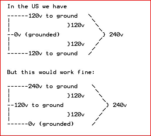

The article confused things by saying "The neutral connection is provided to prevent an open circuit from shutting down power to everything in case of a failure in one branch. It provides an either/or path."
Yes, that's true, but not the most important function which is to SOLIDLY ANCHOR THE SYSTEM TO A 0V (GROUND) REFERENCE POINT.
The neutral would have zero current only when the load on both 120v legs it equal, which generally is never the case. Any imbalance FORCES current flow on the neutral. Since the neutral is solidly tied to the center tap of the winding (and ground) it has to stay at the 0 volt potential, but the result is current flow on the neutral equal to the DIFFERENCE between the two legs. Kind of like how a zener diode regulates voltage, once the zener voltage is reached, the potential cant climb any more, the harder the circuit tries to drive the potential up, the more current the zener has to pass.
BTW,
The choice to ground the center tap was made to limit any point in the system to a max of 120V above earth (ground) potential. 9 out of 10 times when someone receives a shock it's ground to phase, not across the entire winding.
In the US we have;
Edit: <snip messed up drawing> See next post.......
It would just be more dangerous if you happen to touch the higher leg.
Trying again
Edit; I don't know WTH the problem is with ASCII art on this forum engine but it looked right when I posted. The engine doesn't like white space apparently. See attached...

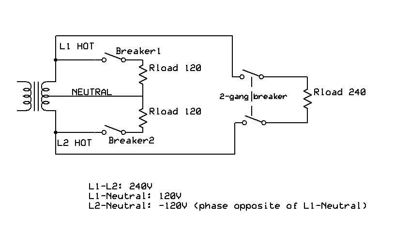

Maybe a schematic will help make it clear. It shows two 120V legs, with one circuit each (1 breaker and 1 load per leg), and a 240V circuit with a 2-gang breaker and load.
housecircuit-gif.35486
So, basically a 120V circuit is between one side of the transformer secondary and neutral (center tap). A 240V circuit is across the entire transformer secondary, the center tap doesn't come into play (except indirectly via safety grounding). The neutral is connected to ground at the panel.

The neutral return current is confusing to a lot of licensed electricians.
When wiring a house, the installer distributes the 120 vac loads, which are light fixtures and outlet sockets to try and balance out the possible 120vac loads on each half of the 'transformer'. Breaker panels do a swap of L1 & L2 phases (the ends of 240vac transformer) for every other breaker position down a vertical row.
In reality the random useage within the house determines how much load is on L1 or L2 phase.
Now for example, If the 120vac loads where exactly equal on L1 & L2 phases to neutral, there would be no neutral current on the neutral line back to the transformer.
Now for a more realistic example, say all the 120vac lights, hair dryer, TV's, etc. turned on resulting in 120 vac loads of 20 amps on L1 side of transformer and 30 amps on L2 side of transformer. There would be 10 amps of current on the neutral line back to the transformer center tap.
240 vac loads like central air conditioner, water heater, clothes dryer, and cooking range create no neutral current as they are directly across the L1 and L2 connections.

Thanks guys, the neutral current thing still bugs me a little, but I do see how grounding the neutral helps the system stability and balance.
