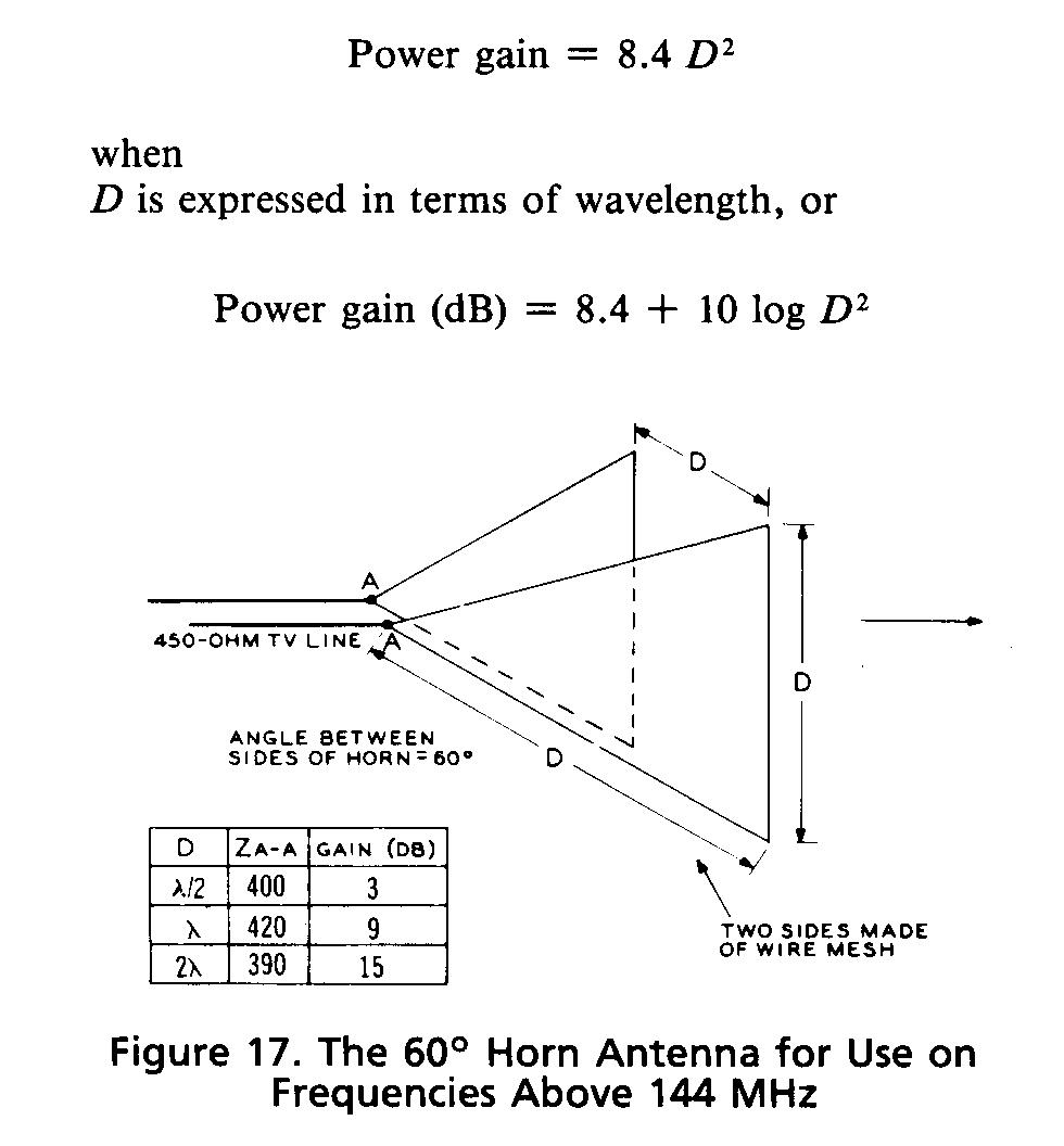

My favourite indoor antenna for UHF TV dx'ing is a TEM mode horn.
figure
This is broadband and really easy to make in a quick and dirty fashion, and almost no-one knows about them. I used to use a large cardboard box (e.g. from a household appliance) and just keep two sides. Using kitchen aluminum foil make the triangles, if you need to join it simply overlap a few inches and use sticky tape. You can adjust the angle between the triangles by opening/closing the cardboard sides. Use a 300ohm to 75 ohm balun to connect your coax to the apex. At 500MHz, making the sides of the triangle 1.2m gives you about 15dB of gain - nothing else to do (except bear the brunt of your family's jokes as you play with your large cardboard box!) I used to be able to knock one up within about 20min of finding that what I wanted to watch was on a distant channel.

Pls, could you describe the construction details a bit more,
1. Is the entire inside of the horn/only the triangles lined with aluminium foil?
2. must the triangle be made with wires?
3. 450 ohm TV cable?
4. must A-A be as close to each other as possible, so as to get 60 degrees?
5. Broadband?, Does that mean i don't need to design the ant to the desired frequency of 582MHz? making the D= 103.2m ( 40'')?
Thanks!

1. Essentially you make two triangles, they come close together at one vertex and then they flare out at about 60 degrees.
2. no, I used Al foil, any metal could be used. Mesh would be OK at lower frequencies (or fine mesh for higher freq). If you use a mesh, I'd suggest using solid plate/foil for say the first 20cm or so.
3. the feed impedance is about 400 ohms, close enough to 300 ohm feeder, or use a 300ohm to 75 ohm balun. This is important, don't just connect it to 75 ohm coax.
4. say 1cm apart, not super critical. I used a standard balun with about 150mm of bare stranded copper wire on each terminal, I simply laid these on the Al foil and laid a strip of sticky tape on top of each one.
5. yes, this is one of the major benefits, it is very broadband so dimensions are not critical. The bigger the better (more gain).

Both antennas would work great, the horn is easy to lash up for indoor use, but harder to weatherproof and mount in wind. If you want more gain from the horn make it bigger, I would suggest it is much easier for a beginner to get lots of gain from a big horn than any sort of array.
The biquad is a great antenna, and you will get 15-17dBi of gain from an array of 4, and it is easy to make it rugged and weatherproof. The point I was making is that you can't lash it up in 20 mins (or I can't at least), and there are quite a few points that could trap a beginner.
I would disagree with your points though, a horn with D=2.5 wavelengths is much more likely to give you 17dBi than a home made 4 element biquad, and the biquad has 50 ohm impedance which is a worse mismatch to your 75 ohm TV than the horn fed through a normal balun. (Neither mismatch is really worth worrying about though).
