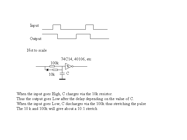

You can do it with a Hex Schmitt Trigger such as the 40106, 74HC14, etc.
You need 2 resistors, one diode and one capacitor per Schmitt.
Here is one way to do it. It is designed for a 10:1 ratio.
You can change the 100k to give you a different ratio.
Change the capacitor for longer or shorter times.
I just posted a circuit. It does work, I've used it many times.
For example, I used it in a garage door opener. I wanted to make the light stay on for about 2 minutes.
So the delay is started when the up or down button is pressed and remains on for approx 2 min.

The circuit is 5 posts above.
You could also use the same technique with 556 ICs, but there are only 2 per IC so it is probably more expensive.
Do you have to have a positive trigger and a positive output?
If not, then you obtain 6 circuits per 40106.
Alternatively, as someone wrote, you could use a dual Monostable.
Then you only need one R and one C.

Why can't the PIC generate a "negative" pulse?
cos if there is an intermittent contact I'll have a output??? I'm using it if to drive a relay but if the relay is on for > 1.5 seconds it gets very hot.

For 50 circuits you only need 25 Monos or 25 of the 556s.
It is difficult to give you advice when I don't know the full story. More questions come to mind than I have answers for. For example
Are ther e50 PICs and 50 delays or one PIC and 50 delays?
Why can't the PIC do the 1.5 sec delay?
Does the PIC have any spare i/o?
Could the relay be driven by a PNP transistor? If so, a "negative" output from the delay circuit would work.
