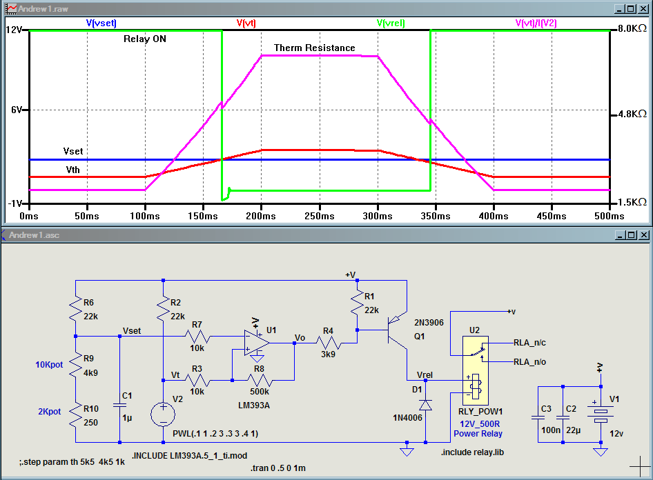

Look at this option, its gives the ~5K operating point for the Therm resistance that you have measured.
The +12V supply should be regulated.

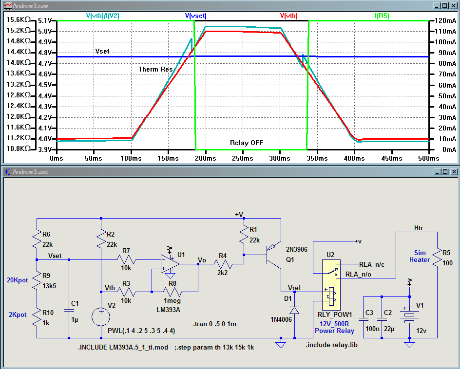

Look at this modified circuit.
Rtherm= 14k5 at 3Cdeg.

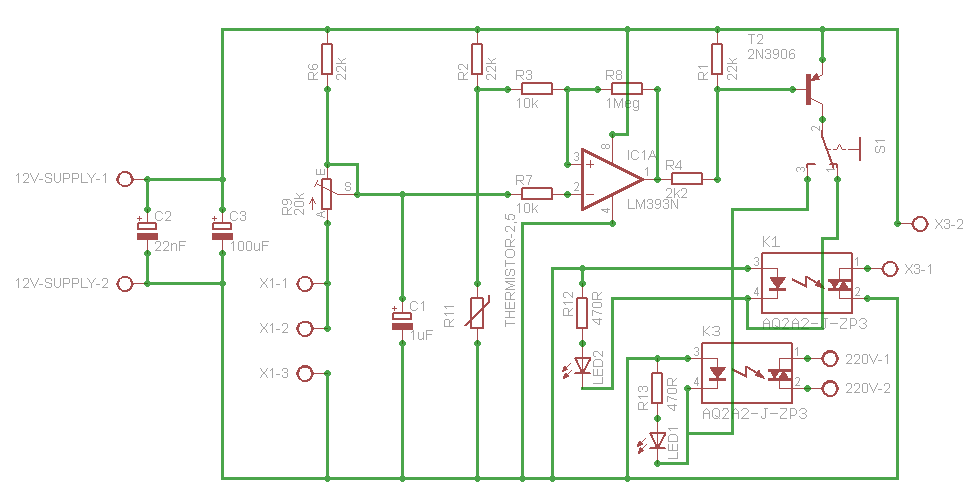

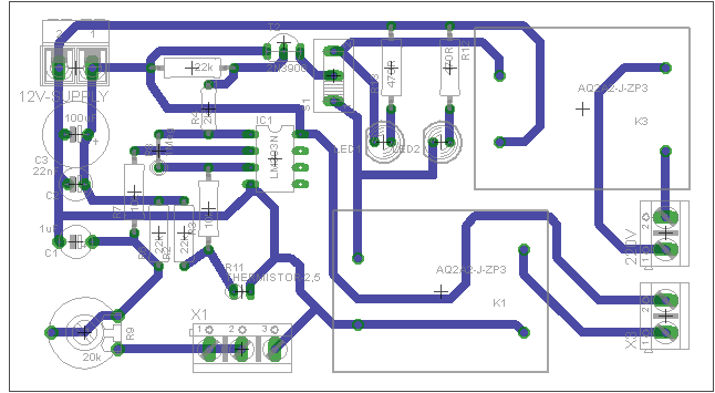

OK,
was trying to get clever here. Could you please check the following?
1.) Wanted the have 12 and 220V element capabilitiies so I put in a selector switch after the 2N3906 to drive either one of two SS Relay's. I don't know if this is possible?
2.) Wanted to have a visual display of which relay was working so put in two LED's and resistors, will they work as inserted?
3.) Will the 2N3906 drive a typical SS Relay? And will the output of the one SS Relay drive that automotive relay that will be off board?
4.) Was I correct to omit the diode protecting the relay as there appears to be an internal diode on the SS Relays?
Andrew
PS: Connector X3 feeds the coil of the 12V Automotive Relay

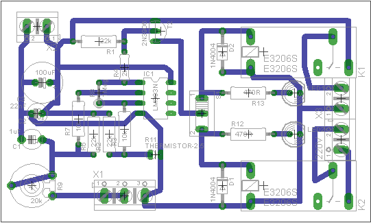

OK,
Andrew
I didnt know you had decided to use SS relays!.:)
Your circuit with the SSR's its very wrong, dont build it that way.
EDIT: you are showing SSR 'ac' type relays, I thought the fridge heater was 'dc'

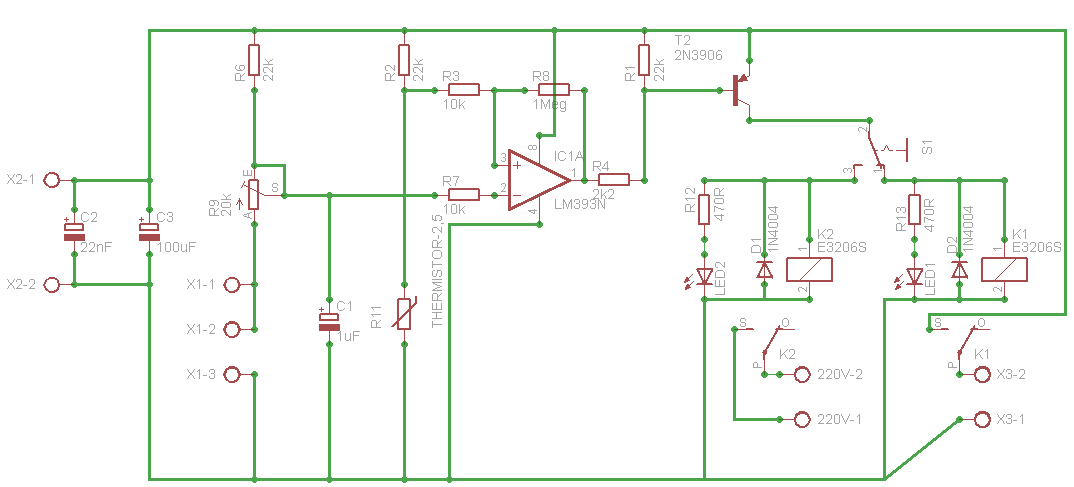

OK here is the way you intended. I hope;
-please check the if the dual relays will work with that switch and if the LED's will operate correctly to indicate which relay is functional.
-will the the one relay be OK to pull in the automotive relay (think it was an 80 ohm coil). I can't see any issues with it as it is acting as a switch rather than having to power a coil. The contacts are X3.
Andrew
