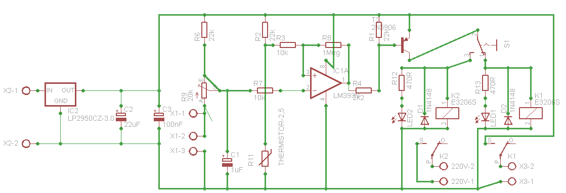

Eric, have you checked the circuit layout and schematic I produced, nothing stops me from getting the board produced now as only the resistor values will change .... or should I wait a while.

hi Andrew,
Your results for the thermistor are very close to the expected values.
The last circuit you posted looks OK to go, dont use the earlier version with the SSR's.:)
The +12V should be regulated for best performance.
The hystersis resistor value should be selected to suit the high/low limits of the required tempr.

New Circuit (yours)

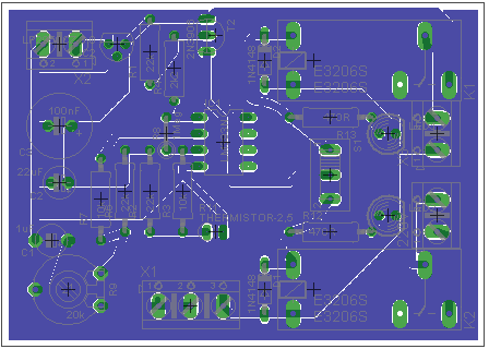

Before I get the board made some clarification please. The LM 2940 calls for two capacitors to be included under certain conditions. C1 if the regulator is located far from the power supply filter and C2 for stabilty. You had already included a 22uF in your original circuit, must I add another one?
Attached is the revised schematic and board.
Is it good practice to etch only around the tracts like I have done (ratsnest)?

Thermistor data https://www.electro-tech-online.com/custompdfs/2009/10/WMF11-XXX_AMPRON.pdf
The two additional caps close to the Vreg should be 100nF.

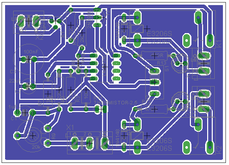

Ref the etching, its hard to see on that image, but do you mean that you have only etched a copper free border around each track/pad.?
If yes, whats the width of the clear gap.?
The thermistor at 4k7 @25C should be OK, I will do a calculation.
The curves on a therm are not linear.
Will do
Yes
They were 0.20mm have increased them to 0.50mm. See new image (does not include the caps).

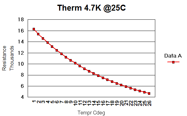

hi
This the thermistor plot 4.7K @ 25C, so it fits nicely with what you have found in practice.
I wondered why our two readings differed.:)

EDIT: the etch looks OK, its not the way I would do. If you are confident you will get no solder bridges try it.
No will revert to purely the tracks then, better safe than sorry
Most domestic fridges dont work to a 1Cdeg tolerance, providing the tempr stays lower than 5Cdeg, the recommended temp for keeping food cool and higher than 1Cdeg , so it dosnt freeze your milk, I would settle for that.
So i'm being a little pedantic then LOL?
What the equation to get the plot?
Andrew
Ra= Therm resistance at the desired tempr.
R0 = 4k7
T25= resistance at which the 4k7 is measured.
Tabs= 273C
Ta = Therm tempr
4100 is the Beta value for the therm material, there are a range of Beta values.
Ra= R0 *exp(-4100*(1/[Tabs+T25] - 1/[Tabs+Ta]) )
Ra= 4700 * Exp(-4100* ((1/(273+25))-(1/(273+2)))) = ~ 14.8K
OK.?:)
Hi Eric,
I have been going through Mr Paisleys tutorial on volatage comparitors. Slowly it is dawning on me, I think. In it's simplest form would this statement be correct.
"There are two inputs, these are basically like an electronic N/O or N/C state in a relay. In our configuration we have set the reference voltage on the non-inverting input, this means that as long as the reference voltage exceeds that at the inverting input that the circuit will output signal from Pin7.
We have a voltage divider at Pin 3 (Ra=Rb) so therefore the reference voltage to Pin 3 in a 12V circuit will be 6V. Connected to Pin2 is what I would call a variable voltage divider as one of the elements is a variable resistance i.e. a thermistor.
As the resistance in the thermistor decreases so the voltage at Pin2 increases, when this voltage exceeds the reference voltage at Pin3 then Pin7 stops sending a signal and the circuit is effectively in the OFF state.
However time between cycling is nominally wide as the ON or OFF state is in degrees and not a sudden ON or OFF. To reduce this effect a resistor is introduced between + and Pin 7. This resistor provides some feedback voltage to the reference voltage at + allowing the switching to improve in response time (will need to get my head around this)"
If this is a about right then I want to learn how to calulate the voltages around the circuit to really understand whats going on.
Cheers
Andrew
Hi Eric,
Our Vref or Vset [ req tempr] is on the Inverting input.
this means that as long as the reference voltage exceeds that at the non inverting input that the circuit will output signal from Pin7.
The output of the comp will be low, so the transistor is ON.
We have a voltage divider at Pin 3 (Ra=Rb) so therefore the reference voltage... not the Vref/Vset but the Vsense from the Thermistor... to Pin 3 in a 12V circuit will be 6V.
The pin3 voltage will be dependent upon the thermistor resistance
Connected to Pin3 is what I would call a variable voltage divider as one of the elements is a variable resistance i.e. a thermistor.
As the resistance in the thermistor increases so the voltage at Pin3 increases, when this voltage exceeds the reference voltage at Pin2 then Pin7 goes high and the transistor is switched OFF
However time between cycling is nominally wide as the ON or OFF state is in degrees and not a sudden ON or OFF. To reduce this effect a resistor is introduced between the non inverting and Pin 7.
This resistor provides some positive feedback voltage to the thermistor voltage at non inverting , which adds to the thermistor voltage, allowing the switching to improve in response time.
This extra added voltage means the thermistor resistance must reduce much further before the total voltage at pin3 is less than pin2. [to switch the transistor ON state]
When pin1 goes low again,at switch over, as thermistor warms up, this extra positive feedback voltage is removed, so the 'gap' or switching points are changed by the positive feedback
